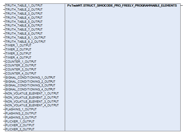

5.4.1.2.11.2.11. STRUCT_SIMOCODE_PRO_FREELY_PROGRAMMABLE_ELEMENTS
TRUTH_TABLE_1_OUTPUT
BIT
[216] Truth table 1 3I/1O output
TRUTH_TABLE_2_OUTPUT
BIT
[217] Truth table 2 3I/1O output
TRUTH_TABLE_3_OUTPUT
BIT
[218] Truth table 3 3I/1O output
TRUTH_TABLE_4_OUTPUT
BIT
[219] Truth table 4 3I/1O output
TRUTH_TABLE_5_OUTPUT
BIT
[220] Truth table 5 3I/1O output
TRUTH_TABLE_6_OUTPUT
BIT
[221] Truth table 6 3I/1O output
TRUTH_TABLE_7_OUTPUT
BIT
[222] Truth table 7 2I/1O output
TRUTH_TABLE_8_OUTPUT
BIT
[223] Truth table 8 2I/1O output
TRUTH_TABLE_9_1_OUTPUT
BIT
[224] Truth table 9 5I/2O output 1
TRUTH_TABLE_9_2_OUTPUT
BIT
[225] Truth table 9 5I/2O output 2
TIMER_1_OUTPUT
BIT
[232] Timer 1 output
TIMER_2_OUTPUT
BIT
[233] Timer 2 output
TIMER_3_OUTPUT
BIT
[234] Timer 3 output
TIMER_4_OUTPUT
BIT
[235] Timer 4 output
COUNTER_1_OUTPUT
BIT
[236] Counter 1 output
COUNTER_2_OUTPUT
BIT
[237] Counter 2 output
COUNTER_3_OUTPUT
BIT
[238] Counter 3 output
COUNTER_4_OUTPUT
BIT
[239] Counter 4 output
SIGNAL_CONDITIONING_1_OUTPUT
BIT
[240] Signal conditioning 1 output
SIGNAL_CONDITIONING_2_OUTPUT
BIT
[241] Signal conditioning 2 output
SIGNAL_CONDITIONING_3_OUTPUT
BIT
[242] Signal conditioning 3 output
SIGNAL_CONDITIONING_4_OUTPUT
BIT
[243] Signal conditioning 4 output
NON_VOLATILE_ELEMENT_1_OUTPUT
BIT
[244] Non-volatile element 1 output
NON_VOLATILE_ELEMENT_2_OUTPUT
BIT
[245] Non-volatile element 2 output
NON_VOLATILE_ELEMENT_3_OUTPUT
BIT
[246] Non-volatile element 3 output
NON_VOLATILE_ELEMENT_4_OUTPUT
BIT
[247] Non-volatile element 4 output
FLASHING_1_OUTPUT
BIT
[248] Flashing 1 output
FLASHING_2_OUTPUT
BIT
[249] Flashing 2 output
FLASHING_3_OUTPUT
BIT
[250] Flashing 3 output
FLICKER_1_OUTPUT
BIT
[251] Flicker 1 output
FLICKER_2_OUTPUT
BIT
[252] Flicker 2 output
FLICKER_3_OUTPUT
BIT
[253] Flicker 3 output
