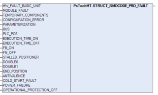

5.4.1.2.11.2.10. STRUCT_SIMOCODE_PRO_FAULT
HW_FAULT_BASIC_UNIT
BIT
[192] Fault - HW fault basic unit
MODULE_FAULT
BIT
[193] Fault - Module fault (e.g. IM, DM)
TEMPORARY_COMPONENTS
BIT
[194] Fault - temporary components (e.g. memory module)
CONFIGURATION_ERROR
BIT
[195] Fault - configuration error
PARAMETERIZATION
BIT
[196] Fault - Parameterization
BUS
BIT
[197] Fault - Bus
PLC_PCS
BIT
[198] Fault - PLC/PCS
EXECUTION_TIME_ON
BIT
[200] Fault - Execution Time ON
EXECUTION_TIME_OFF
BIT
[201] Fault - Execution Time OFF
FB_ON
BIT
[202] Fault - feedback (FB) ON
FN_OFF
BIT
[203] Fault - feedback (FB) OFF
STALLED_POSITIONER
BIT
[204] Fault - Stalled positioner
DOUBLE0
BIT
[205] Fault - Double 0
DOUBLE1
BIT
[206] Fault - Double 1
END_POSITION
BIT
[207] Fault - End position
ANTIVALENCE
BIT
[208] Fault - Antivalence
COLD_START_FAULT
BIT
[209] Fault - Cold start (TPF) fault
POWER_FAILURE
BIT
[210] Fault - power failure (UVO)
OPERATIONAL_PROTECTION_OFF
BIT
[211] Fault - Operational Protection Off (OPO)
